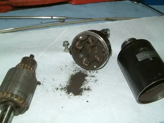

My situation can be described with a photo: enter image description here
That's my starter motor, which doesn't appear to be in a healthy condition.
What I would like to know is, can I avoid spending over $500 on a new one in any reasonable way? Getting a used one on ebay or any other online shopping place is not an option, as I need it fixed in one week max and getting an used item is slow and risky. Delivery is slow to Romania and I get the risk of getting a defective one, or one that will break down soon.
Can it be rebuilt with commonly available components?
Can I adapt another starter from a different motorcycle model? This particular model is known to break down easily, so it would be great to adapt a more reliable model if it's possible.
Technical details:
  • Motorcycle: Triumph Tiger 800 from 2011
  • Starter: Denso 428000-5540
Thanks!
Alin P.
  • 1,334
From the picture it looks as if your brushes are completely worn out. If there's no other fault, that is (theoretically) an easy and cheap fix. It appears however that getting brushes for this particular starter isn't as easy as it normally should be.
For more information have a look at this thread: http://www.tiger800.co.uk/index.php/topic,11947.0.html
as well as this (in German), which is referenced in the previous one: http://www.tigerhome.de/index.php?/topic/28918-anlasserbürsten/
Ask a local automotive electrician/mechanic, with a bit of luck they'll be able to sort you out quickly and for a reasonable price.

There are companies that can recondition these, at least here in the UK. I have had one of mine done before in a couple of days. I assume they must use common components due to the fast turn around.

Hey guys on this web side I bought my spare parts for my denso starter motor for a Tiger 2012. After around 40.000km the started motor was getting very slow and the brusher were on the very end of there life time-->starting was a gamble
Number on my starter motor is denso 428000-5540
https://www.al-electric.de/index.php?aktion=nummernsuche&nummer=428000-5540%22
article no for sigle brushes 028530-5312 or the other part with the plastic housing attached 028530-5302, Isolator is the 028512-5470
All in all I repaired my starter for around 40€.
