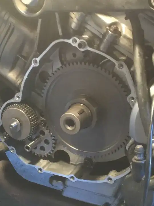

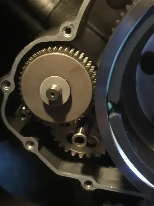

Step 2
Following a basic rule of thumb I just put the two primary gears back in place from where I took them. Are there any special concerns that I should perform at this point?
step-2
Step 3
Do I need to lube up these components before reinstalling?
step-3

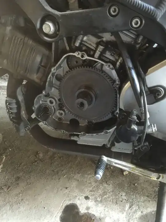

Step 4
I noticed there is quite a gap between the rotor assembly and the back plate. From the back of the rotor, the starter component is not flush with the rotor. Should it be? Anyone able to point me to an image of the back of the rotor assembly? In fact, I seem to recall that the rotor assembly was very tightly attached to the back plate but now when reinstalling; the rotor assembly does not seem to be sticking to the back plate in the same way. I'd like to know what I am doing wrong.
step-4
Step 5
I do not recognize this component. I can see an [-] (i-bar) - in step 10, which I believe goes in between the space but I would really like a reference to this part if there is one in the manual or if someone has an picture of it installed.
step-5

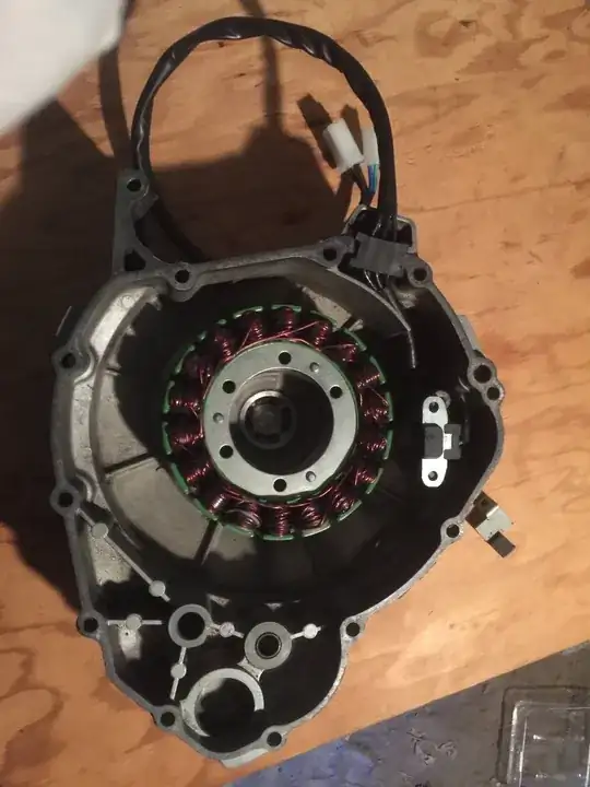

Step 6
I am putting in the replacement stator. I cannot seem to find a description of the type of bolts one should use in this component. I have my old picture but I am considering using new bolts.
step-6

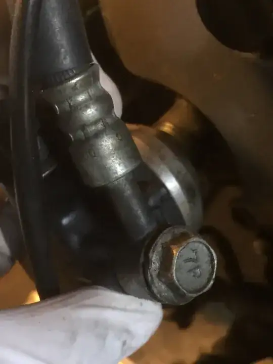

Step 7
I am trying to find information on the assembly of this component. Any pointers would be welcome.
step-7

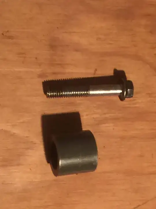

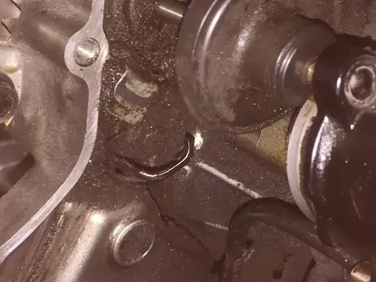

Step 8
I don't recognize where the tube goes, any help would be appreciated.
step-8

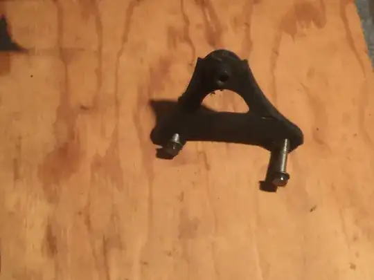

Step 9
Another unrecognized component. If there is a part name or location in the manual please point me in the right direction.
step-9

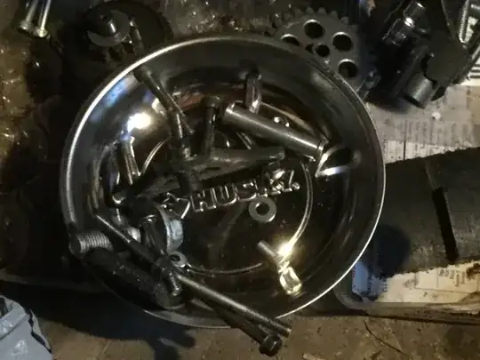

Step 10
I have a number of assorted bolts and haven't been able to identify where everything goes. I haven't been able to spot these in the manual and would appreciate any pointers.
step-10

Yes, use assembly lube. It's not a disaster if you don't. Assembly lube would typically apply connecting rod and main bearings but it won't hurt you to use it when you put your clutch basket on your primary shaft.
Validate that they don't bind during operation and that they are bottomed on their respective shafts. As well, make sure you get ALL thrust washers in their appropriate locations and order.
Lube the shafts.
I can't tell from the picture.
Those components are related to your hydraulic clutch. The rod goes through the primary shaft and pushes the pressure plate away from the clutch basket. The component with three mounting bolts is the hydraulic clutch housing and piston.
Get OEM bolts. They are case hardened M4's
I am trying to find information on the assembly of this component. Any pointers would be welcome?
That's your master cylinder again. The line attached is for the brake fluid. Ensure all the surfaces are clean. The master cylinder will fit into the case. If you clean all the chain lube gunk around it you will see the mount bolt holes better, perhaps, and see how the device lines up.
That's not a tube. It's a bushing. It could go inside the inner clutch basket and ride on your primary shaft but the outside of it doesn't seem worn so that may be a red herring. I don't know how much you have disassembled so it's difficult to determine where the component may have originated from.
That is an external component. You can tell from the bolt heads. Those are Suzuki external case cover bolts used on the outside of their engines. The mount you have there may hold another component into place. I would hazard a guess this piece mounts to the outside of your clutch cover.
Impossible to say. Need to see the state of reassembly. I do recognize some gas tank mount bolts, internal allen head (case hardened)
