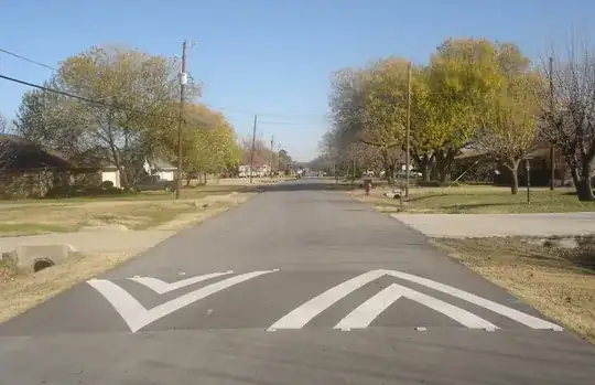

  • Repairing damage from going over speed humps at speed, loads of them round here have scrapes from exhausts on.
As everyone always asks what things are, here is a speed hump (shamelessly stolen from Wikipedia):

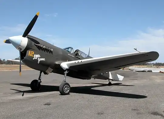

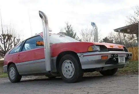

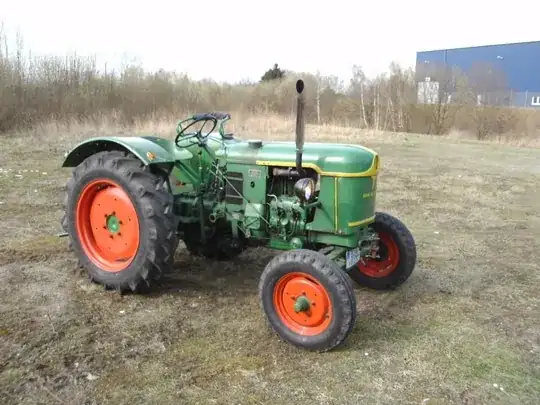

Well, we can have a pipe going out the front of a car as in this design here: tractor or its heavier predecessor: enter image description here Arguably, the aerodynamic properties are not optimal in both, but here is a similar approach where aerodynamics have been considered for sure: piston engine plane other designs (like trucks) do account for aerodynamics by putting the exhaust tubing behind the relevant frontal surfaces and letting the exhaust stream exit sideways or upwards. You might even see this in a passenger car, although I'd doubt its usefulness: Mazda 3 tuned with truck exhausts
What's common to all of these cases is that designers had plenty of room to work with to direct the gases away from the drivers'/pilots' noses. Specific properties of the respective vessels were serving the same purpose, too.

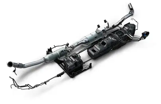

You might not have this in most standard factory model passenger car designs, so the problem had to be solved differently. As an exacerbation from the engineer's point of view, you will have to accomodate exhaust gas treatment facilites and silencers somewhere and something like a DPF/SCR system (Diesel exhaust cleaning) will take up plenty of space on its own: SCR catalyst

Take that airplane with the short, up-front, direct exhaust pipes. Start it up in your driveway early on a Saturday morning. See how popular you are with your neighbors.
