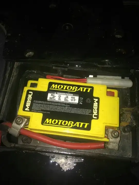

I can't find the fuse box on a TGB Urban 125cc scooter. I looked under the seat and under the foot rest. All i could find is the main fuse wired in the battery cable:
tgb urban main fuse
Is this the only fuse? Is there a fuse box with more? Where is it located?

I can't find the fuse location for the 125cc
but....
The loation of the fuse on the 49cc version is in the battery compartment.
From the manual
BATTERY AND FUSE.
  1. THE BATTERY HAVE TWO TYPE :REFILL WATER TYPE AND SEALED TYPE.
  2. REPLACE THE BATTERY, PLEASE TAKE OFF LEG SHIELD CUSHION, UNSCREW THE TAPPING SCREW AND REMOVE THE BATTERY BOX LID, YOU CAN TAKE OFF THE BATTERY AND CABLE. SEALED TYPE REQUIRING NO MAINTENANCE OF FLUID LEVER, DO NOT REMOVE SEALING CAPS.
  3. THE FUSE IS NEAR THE BATTERY, ITS FUNCTIONS IS TO PROTECT THE ELECTRIC PARTS AND AVOID DAMAGES CAUSED BY SHORT-CIRCUIT OR POWER OVER-LOAD, IF THE FUSE MELTS OFTEN, THEN THERE MAY BE SOME THING WRONG IN THE ELECTRIC WIRES OR THE ELECTRIC PARTS DO NOT WORK CORRECTLY. PLEASE GO TO AN AUTHORIZED DEALER TO EXAMINE IT IMMEDIATELY.
  4. IF REPLACING THE FUSE, PLEASE ALWAYS USE A 7A TYPE.

Did you try looking in the battery compartment area? Sometimes those fuses will be directly wired into the positive battery cable (those smaller scooters typically have a single fuse I think, don't quote me though).
