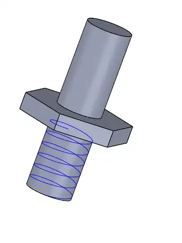

I'm trying to fix the shifter on my dirt bike.
I've located the problem, which is a pin that's come loose. The shifter kind of works, but every now and then it gets jammed because this loose pin isn't properly restricting the movement of the part and you need to force it back into place
It's supposed to be turned with a 14mm socket or wrench, and i can get to it, but I can't rotate it more than 1/8th of a turn because the clutch housing is in the way. I'd really rather not have to take the entire bike apart just to tighten this one bolt...
It kind of looks like this:
Long story short: Does anybody know of something I can use to grab the smooth end of the pin hard enough to tighten it, or anything else I can try?

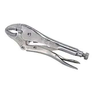

That way, you can turn it a little bit at a time. Failing that, if you REALLY want to try to grab the pin, try some vice grips. Tighten them to the appropriate width, clamp them down, and try to turn.. You'll likely damage the pin with the grips.
