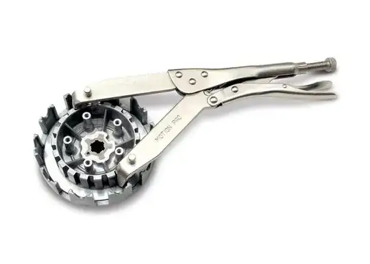

You need a clutch basket removal tool
This tool will allow the inner and outer clutch basket to become locked together in order for you to remove the bolt that is affixed to your transmission primary shaft.
This is a relatively cheap tool. I recommend you use an air impact to remove the bolt. Upon tightening you will want to use a torque wrench and lock your crankshaft on the stator side with a wrench.
Here are some selections to source the tool from.
