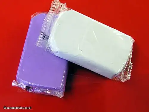

The clay bar itself is pretty much what the name implies, though it's not made out of organic or natural stuff, but more-so is a synthetic (man made) clay specifically designed to do what it's designed to do: remove paint contaminates. A typical bar of clay comes wrapped up like this:

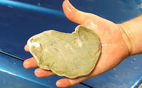

They can come in just about any color. When you first pull the clay out of the wrapper, you need to knead it, as in, fold it back on itself and get it more malleable. When actually using it, you need to also use a lubricant with it to ensure it isn't sticking to (or grabbing) the clear coat in the process. Here is an image of what it kind of looks like when in action:

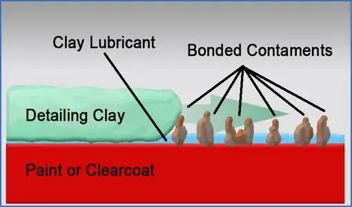

The contaminates are stuck to the clear coat, while the clay bar comes along and intercepts them, absorbing them into itself. To do this correctly, you need to continually fold the clay bar back on itself to further encapsulate the contaminants inside the clay bar. When in use, the clay bar will look like this, and is how you'll know it's working:
