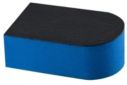

I was checking out various different clay bars and ran across this Nanoskin product with quite allot of good reviews which is supposed to be an easier substitute:
I was wondering if anyone here had encountered this product and if it's really a good substitute for claying in the "clay, polish, wax" process for the average person who is not taking their car to a show and just wants it to look decent.

I've used both clay bar and clay mitt (similar to the product you've posted).
Advantages of clay mitt:
  • if dropped, you can clean it off and use it rather than throw it away
  • typically covers larger surface area in a single pass, allowing for quicker claying of the whole car
Advantages of clay bar:
  • you can continue to fold and expose new surface to maintain efficiency
  • you can get get different strengths to tackle different levels of contamination
Both need oodles of surface lubrication (clay lube or soapy water) to prevent marring the paint surface.
Both will eventually need to be replaced after they pick up sufficient contamination.
