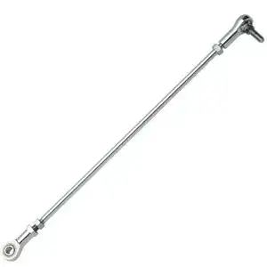

It's part of your shift linkage
Here is a shift rod that transfers power from your shift left to your shift drum via the shaft that will rotate when you shift.
The shift rod has ball joints on either end. This is the likely source of your squeak. Use a lubricant on them, preferably a dry lubricant.
Once lubricated the sound should go away.
Shift rod w/ ball joints
