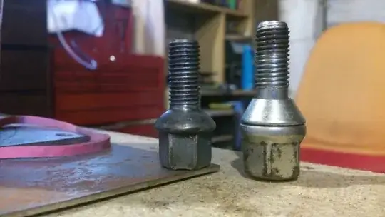

Talking about bolts for steel and aluminium wheels - they should have different bolts. Alloy wheel bolts have longer thread and cone shape (on the right). Steel rim bolts have shorter thread, and a spheric shape (on the left). enter image description here
So if you buy steel rims, make sure you buy bolts. Sometimes too long can hit something behind the wheel...
