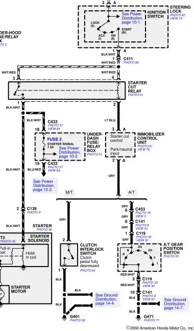

There's also often other switches and such that can prevent the starter from starting the vehicle (by disrupting the electrical connection to it) such as the shifter switch on an automatic (making sure you e.g. can only start the car in park/neutral), the clutch pedal switch on a manual (making sure you can only start the car with the clutch open), etc. You'd have to check the wiring diagrams for your car. Here's the relevant portion, as an example, from a 5th gen Honda Prelude:
There you can see that the immobilizer (along with the shifter / clutch switch) have the power to prevent the starter cut relay from closing, thus preventing power from going to the starter. The ECU (not shown here) also cuts power to the fuel injectors if the physical key is not present (so you can't e.g. hot wire then bump start it).
