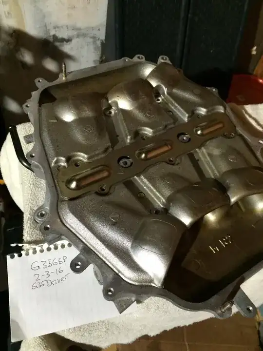

EDIT: Pictures of my setup. I think I used 24" of high pressure hose total, and my canister happens to sit nicely behind the bracket that holds the PS reservoir.

For your application, I'd say that would be the best method, as a sealed system will give you the best idea how much oil you're losing through the PCV. My reasoning for installing a catch can (besides wanting another project to do) was to keep hot oil out of the intake plenum since I had also installed a modified lower plenum, plenum spacer, aramid gasket, SRI, and copper TB spacer, which made a noticeable difference in plenum temperature. Having again removed the upper plenum after 10k with the catch can, I was pleased to see the plenum was still more or less oil free vs when I took the original plenum out (see picture below).
I was surprised how much oil I 'caught' after installing the can. I empty it every couple weeks (500-700 miles) and it's usually getting close to full (150 mL), unfortunately that's nowhere near the half quart (1000ish mL) you're losing every 700 miles, but it'd still be worth looking in to.

Below is the old lower plenum after 85k miles without a catch can. It's not a great photo, but you can see the oil residue in front of and on top of the runners. When the clean plenum was installed and run 10k with a catch can, it still relatively new (thin film of oil in the vally that's inside the runner in the bottom right of the picture).
