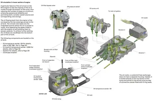

Eeek, I see oil in the coolant reservoir of my W12 Touareg.
As far as I can tell, engine temps were stable and normal prior to this sudden occurrence. Based on this, my top suspect is not the head gasket, but the oil-cooler, which is a coolant/oil heat exchanger.
This is not a cheap part, and I expect the dealer to charge a handsome fee for labor, so I'd like to be sure that it is indeed the oil cooler and not something more invasive like a head gasket (shudder).
Here is a diagram of the oil circulation system on the W12
W12 Cooling System
Question
Is there a way for me to diagnose the leak, preferably with the oil cooler in situ?
(I feel like I'm clutching at straws with the "in situ" part of the request)
A lot of YouTubers like to submerge the cooler in water and use compressed air to look for bubbles, but this obviously involves unbolting the oil cooler from its home in the engine bay.
If extraction is the only option, I can understand that - just that I'm not looking forward to the ordeal.

If those are coolant pipes on the side of it, you could join them together so that they bypass the cooler. If the leak stops you know that the cooler was causing the problem. You may also find that oil comes out of the coolant fittings which will also indicate the fault is with the cooler.

Another possibility as an alternative to @myself's idea is to connect pipes to the oil cooler and then connect them to a vacuum pump. If you pull a small amount of vacuum and it holds the vacuum overnight then the cooler is probably OK. This will avoid pushing water into the engine oil. A vacuum pump with a pressure gauge like one used for air conditioning evacuation would be ideal.

Suggestion:
  • Remove the coolant pipes.
  • Connect two long, transparent, pressure resistant hoses.
  • Place the two hoses upward, fill them with (colored?) water and bleed the entire assembly using an external water pump or hose.
  • Mark the water level on the tubes
  • Figure out the designed cooling system pressure. Now put those two tubes under pressure (compressed air)
  • Let it stay overnight
If the water level has changed there must be a leak.
Perhaps you must adjust it to match your situation, but I am sure you get the idea. However, there is a possibility for a false negative: When the leak only opens when the oil/water is hot.
