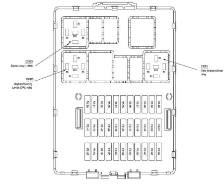

There is a starter relay in the central junction box (behind dash panel left side), it could be defective. Starter relay location image below. You can swap the drl relay with the starter relay to verify if it will start now.
