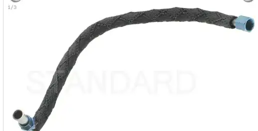

Since you qualified the exhaust system has no leaks, check the erg tube for leaks, also check the exhaust manifold gaskets if it has them, between manifold and cylinder head.
Also check for oil leaks that drip onto exhaust manifolds, this will create CO and will get sucked into the passenger cabin.
Best way to check for exhaust system leaks (exhaust manifolds back to tail pipe) is to use a smoke machine connected to the tail pipe(s).
To check for hydrocarbons (Carbon Monoxide=CO) in the passenger cabin Put a carbon monoxide sensor (similar to what is used in houses and motor homes) in the cabin when you drive, see if it alarms.
EGR Tube image below.
EGR Tube
