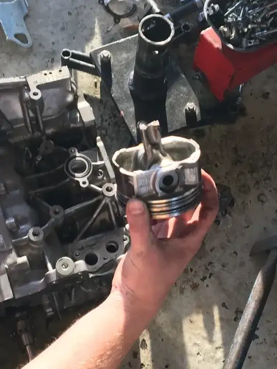

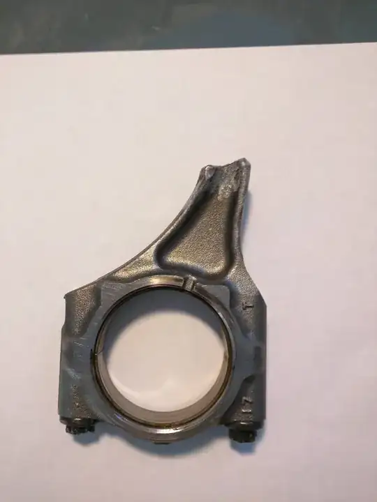

It sounds to me like you 'windowed the block'. When you lost oil pressure, you were at highway speed, so your engine was spinning decently fast, and every revolution without oil does more damage. I think the light noise was rod knock and lifter tick, the pop was the rod breaking and making a hole in the block, and the cloud was the oil that was left in the engine, now exiting the engine and burning.
Hopefully, I am wrong and overlooked some possibility that doesn't result in the engine being completely destroyed.

My son had an engine failure on a 2015 WRX, same exact symptoms, connecting rod broke and punched through the engine block on the top side, breaking open an oil galley. 10K mistake after playing with turbo boost, ouch!
