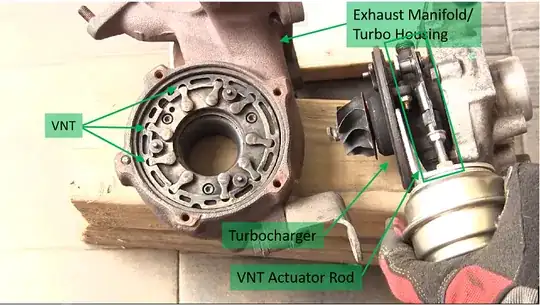

Is there any way that the vane actuator could be moving and yet not actually moving the vanes, or is it a positive linkage?
There is a positive linkage, but it doesn't mean it isn't working right. However, if the linkage is moving freely, the vanes inside the turbo exhaust housing should be moving. The vacuum can (actuator) is where the problems lie most of the time. You can get an excess of soot buildup within the turbo which can cause the vanes not to move correctly, but again, the actuator rod would not be moving either. Here is an image with several of the major parts annotated:
