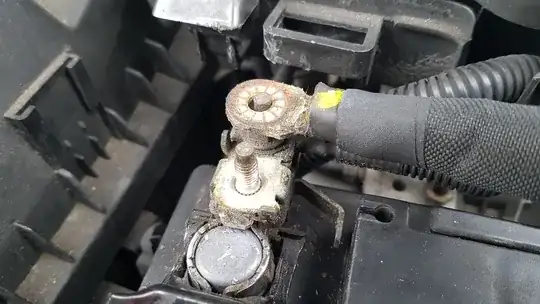

I had the same problem. Couldn't start engine Citroen C5 X7, 2011. Thought it was the battery but the garage said battery health was 98%. Then I unscrewed the cable which goes from battery to starter and realized it was all rusty underneath. I cleaned it with sandpaper and white spirit, assembled, and now starter spins perfectly. Like new. Problem solved.
