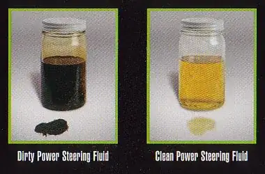

Power steering fluid does not typically see excessive heat depending on the reservoirs/fluid lines location in the engine bay, but it serves both to actuate the hydraulic steering, and cool the power steering pump. Over time, the fluid can degrade, and although it is a closed system, any exposure to heat or moisture will eventually diminish its performance. Either way, the PS fluid is the cheapest and easiest part of the PS system to replace, so it's a good idea to change the fluid as preventative maintenance. When the PS fluid becomes dark/discolored (as pictured below), it's time to change it.
