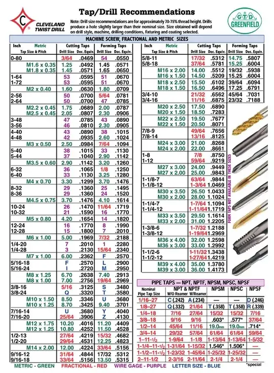

If the hole is truly stripped, then yes that would actually work pretty well. The major diameter of an M7 thread is, well, 7mm. I'm much more comfortable in inches, because that's what my shop works in, so translate that and it's about .275 inches. Lets look at what that is appropriate for on a tap drill chart:
Tap drill chart
If you look at the two M8 options, you'll see that the tap drill size is remarkably close to 7mm, which means that your hole, having its threads ripped out, is properly sized for an 8mm tap. Please note: I would still recommend chasing with the appropriate drill size before running the tap.
If you can't drill it straight enough when only removing trace amounts of material, the tapping is not going to go well either. You also may need a tap extension, and some good cutting oil. Also just be careful not to break the tap. That's just awful.
