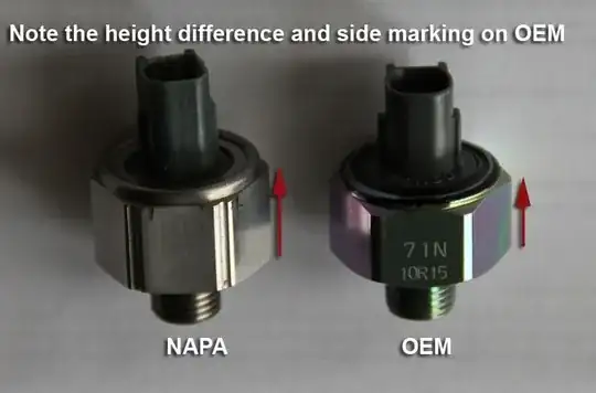

Just in case anyone else runs into this situation. Do not buy aftermarket parts or what are claimed to be OEM compatible parts for your Lexus. At least not electrical signal parts.
I purchased two Denso sensors on Amazon and made sure they had the same markings as the original that came out of the car. It took another 6 hours to tear the intake manifold out and replace the Import Direct sensors with the Denso sensors. Of course, ORiellys won't let me return the Import Direct sensors, so I am out $300 bucks for those.
It has been a week now and I have had no issues. Even though the electrical signals are very similar, they must be different enough that the Lexus doesn't like the Import Direct sensors.
Image Source: http://www.toyota-4runner.org/3rd-gen-t4rs/194340-knock-sensors-harness-diy.html
