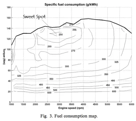

The power output of an engine is determined by how fast it can capture the energy released from fuel. There is an optimal range for that fuel-to-torque conversion, before and after which efficiency falls off. Whichever gear allows your engine to stay in its "zone" is the most efficient gear. If your car wants to shift, trust the engineers that built it.
Incidentally, this is why it's more efficient to "get to the point" when accelerating, getting to that zone of optimal torque more quickly (unless there's a red light in your immediate future). Smarter folks than I discuss the physics of it in this related post, from which I borrowed this image: Combustion engine efficiency chart in which efficiency follows, a rough bell-curve

Engines generally deliver the best fuel economy between 1500 – 3000 RPM, depending on your engine. When you are running under load, the most efficient place to be running is at the peak efficiency point for your engine, which is usually somewhere in that range.
