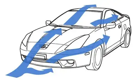

In the simplest terms possible, the windshield acts as a spoiler or fairing, pushing the air out and up as your vehicle gains speed. The air naturally will push back to be along the side of the vehicle.
With the front windows open, there is enough pressure to push the air out away from the windows to give the feeling of less drag.
With the rear windows, the air has come back against the vehicle causing more drag. So, the buffeting you are describing is the air causing drag.
