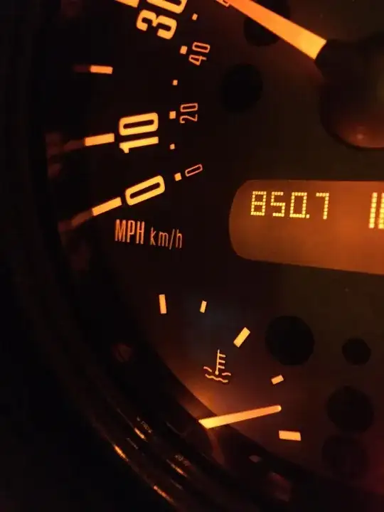

My coolant temp looks like this:
It fluctuates, but never really goes much higher than the first bar. It's not really been a big issue for me, better cold than hot, however the cabin heater has gradually been getting colder and colder as well and now that it's almost winter I'd like to get this sorted.

sounds like your thermostat is stuck open. I would check this first.
You might be able to squeeze the hose going to the radiator and see if you can feel water passing, while the engine is just started and still cold. You should feel very little to none. If you feel a lot then most likely the thermostat is open when your engine is cold which is not good.
The only other thing I can think of is your in a place that is so cold it's basically air cooling your engine but this is not likely.
