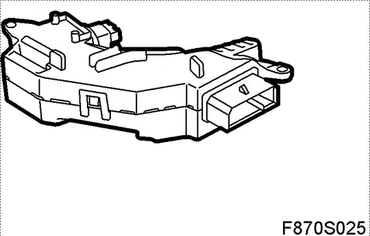

Was it this thing you replaced? It's the Control unit, ventilation fan, ACC (220b).
It's fed by fuse 23 in the dashboard fuse box (IPEC), which doesn't seem to do much else. If those wires were shorting out, you would blow fuse 23; no smoke, no fire, unless something else was badly wrong. I'm afraid your loss-of-power problem has another cause. But rule this out, of course, and insulate those ends.
