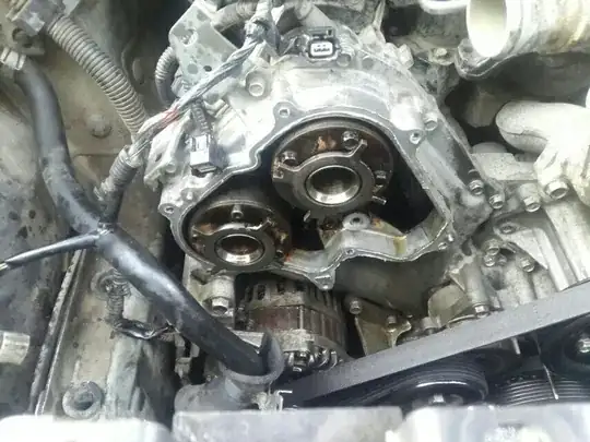

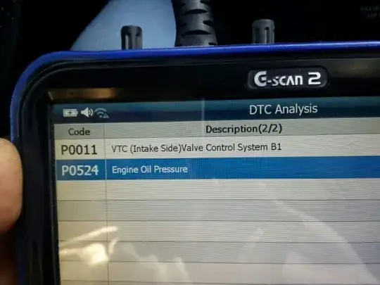

Please, I need help. My care is shaking and this code is appear in comp test p0021 int/v tim cont-b2 1t Please ..i clean the intake valve control timing on both side then after that this code appear p0011 and p0524 of ather side enter image description here
And b2 we see the selenoid vale was damage and i change it and intake valve control timing was blocked by dirty oil we cleaned it befor this code appear

the other code
this has to do with your variable valve timing and could be why you cant rev the engine past about 4k. If it is stuck in low rpm mode then you might be able to get up to a speed but not past it simply due to a lack of power at higher RPMs. This also fits in the solenoid that moves the cam around is sticking so sometimes the variable valve timing does work and gives you more power.
I would really look into the oil issue first before the variable valve timing problem. when you do dig into the variable valve timing I bet it will be a sticky or worn out solenoid.

your oil pressure error code is still something to be concerned about.
And you are welcome! :)
that would be the oil sensor. definitely want to address this as a first thing. low oil pressure means the engine will not last long. and if the cams work using hydraulics to move them back and forth then this could solve the low speed issue too. They can use hydraulic pressure in other ways to create variable valve lift and timing and if you have low pressure it can affect these other ways too.
My guess is you need to replace your oil pump it may be worn out. If you are lucky it could be a plugged up oil pressure sensor. You might want to start there first. Pull the sensor and see if it is caked over with crud.

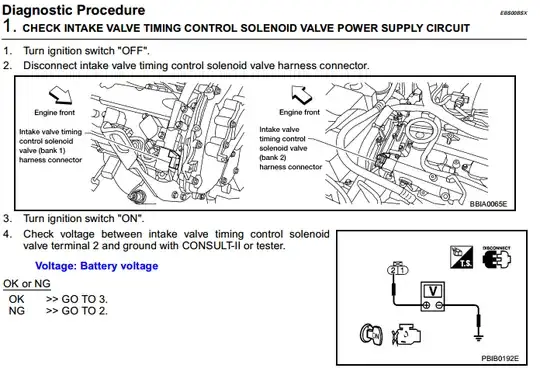

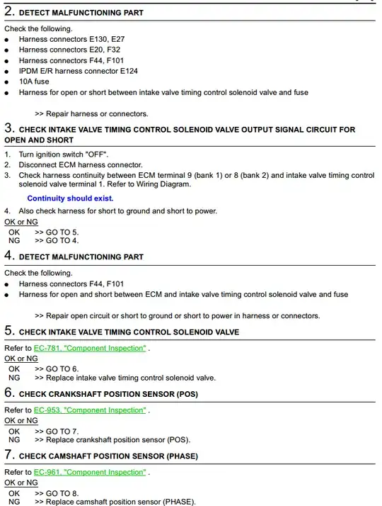

That is good news! here is some instructions for servicing the variable timing solenoid. you may be able to simply clean it with some electric contact cleaner. also look for plugged ports. let me know what they find with the VCT solenoid.

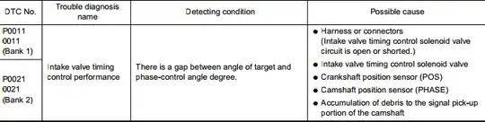

here is some more information on that code

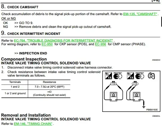

here are some pertinent excerpts from it
Component Inspection EBS00D4K
INTAKE VALVE TIMING CONTROL SOLENOID VALVE
1. Disconnect intake valve timing control solenoid valve harness connector.
2. Check resistance between intake valve timing control solenoid valve terminals as follows
Terminals ----------------- Resistance
1 and 2 ------------------- 7.0 - 7.5Ω at 20°C (68°F)
1 or 2 and ground ------ ∞Ω
------------------------------ (Continuity should not exist)
