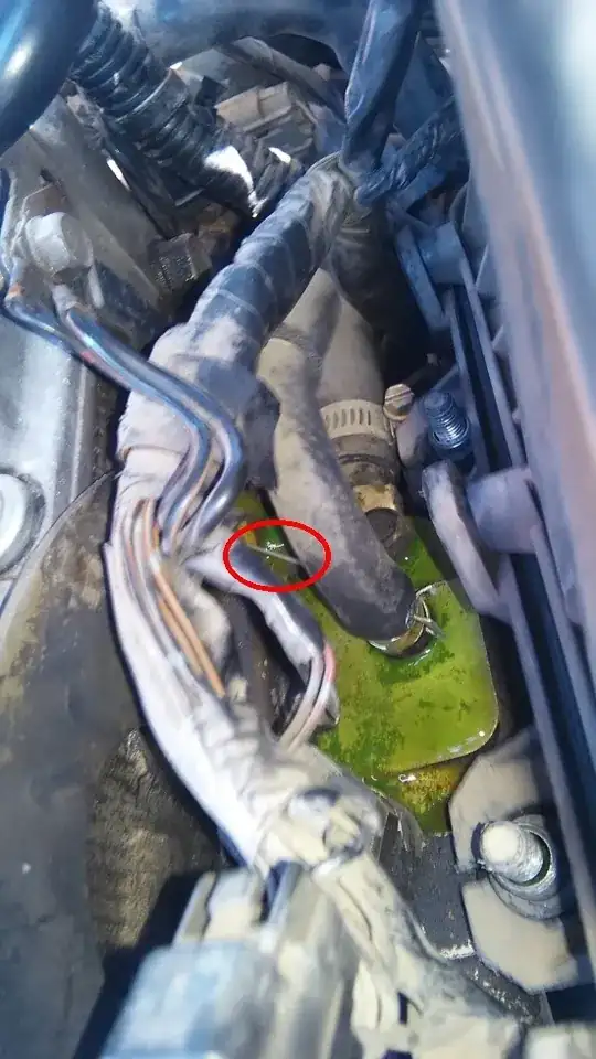

enter image description hereI need to now where it's coming from and how to fix it. My Mercury Sable 99 is loosing about 1/2 gallon every time I drive it It started two week ago then I was only dumping 1/4 of antifreeze in it and out of the blue it stopped for 5 days but started back up 12/4/16 it seem to be leaking from the back of the engine left side tonight on my way home I have lost all heat checked oil its still the color of oil

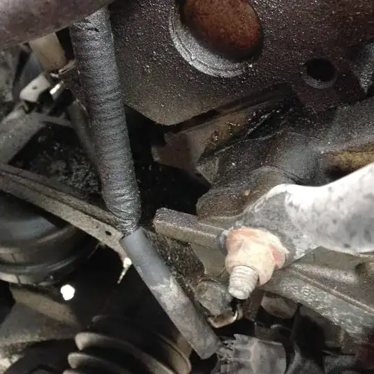

Many times in older cars when a leak develops it's because of a pinhole sized rupture in one of the coolant hoses. When the car is cold you won't be able to see the leek because it will only show up once the system is hot and the coolant is under pressure. So what you should do is refill the coolant then let the car idle with hood open it until it is hot and you'll probably be able to see where the leak is coming from that point. You might also need to rev the engine for a little while until sufficient pressure builds up for the leek to show. Then it is just a matter of picking up a replacement hose and replacing it.
It might look something like this:
Regardless of where the leek is coming from, many times you won't be able to see it until the cooling system is hot and under pressure.
