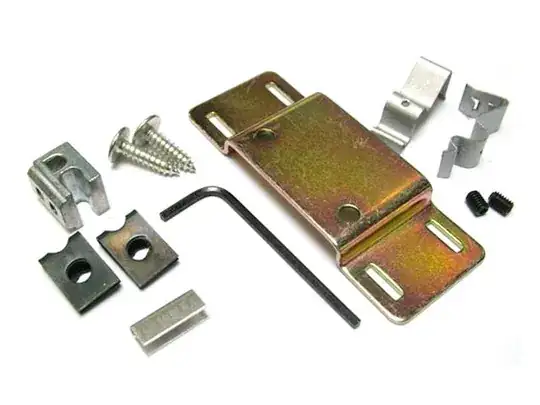

First Method (Cheaper): The first link shows 4 actuators in the set, and if you don't have OEM power locks you'll definitely need those. It's really up to you if you want all 4 doors, and some people opt to only add power actuators to the front doors. There are a couple of gotchas, however. The door locks in your vehicle are cable driven, but most actuator kits don't come with the parts to adapt to cable driven locks -- they're designed for the old-fashioned rod-style. To get most aftermarket actuators to work with cable driven locks (as you'll find in most modern cars) you'll need something like DEI part 524CL. DEI 524CL Those work in combination with generic kits, but provide the hardware to attach to the cables.
Second Method (Better): Get OEM door lock actuator assemblies and add them to the vehicle. Normally aftermarket actuators work well, but for cable-driven applications I it really ends up being hit or miss. Even with the proper adapters listed above, it's not uncommon for the cables to snap if the installation isn't very precise. I don't have specific part number for the versa, but based on past parts I'd guess they'll run in the ballpark of around $130/door.
