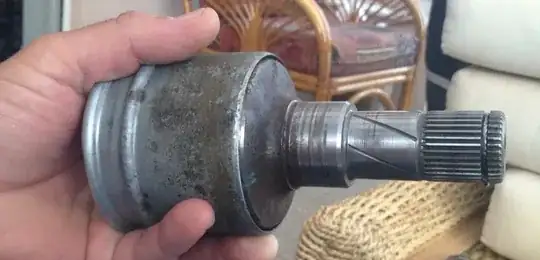

I'm looking for a part for a 2001 SAAB 93 2.2 TiD but I'm not 100% sure what the name of the part is. Essentially it's a sleeve that goes in to the differential which the part in the attached image goes in to:
I've been searching around and from what I gather, the term SAAB uses to describe it is "countershaft insert into diff bearing".
Any help locating one of these parts would be greatly appreciated!

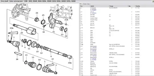

The part on the picture is called "Companion flange" as per Saab's own electronic part catalogue (EPC) - number 7 on the drawing below. I'm not sure which one in particular you need, so here's the drawing itself:
Full size
Check whether your engine type is among the listed above. Part numbers are listed on the right, and you can use those when ordering the components.
This is for Saab 9-3 first generation, which includes your model.
