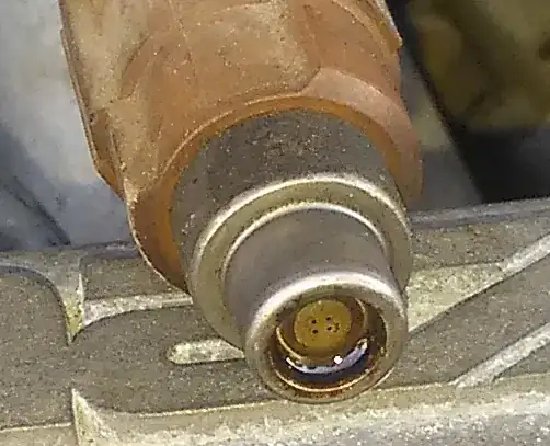

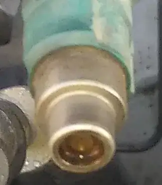

The car sat for 36 hours before I redid these tests, so I decided to check for any leaks before I did anything else. The #2 and #3 injectors were completely dry, but the #4 injector was noticeably wet, while the #1 was also a little wet:
Number Four Injector:
Number One Injector:
So I'm guessing I've got a bit of a leak from these two injectors, and as it happens these correspond to the spark plugs which had carbon fouling. I'm guessing this might be part of the reason I'm having rough starts after the car sits for a while. When I started the car after doing these tests it started up smoothly, which I'm assuming is due to the fact that fuel lines where properly pressurized as a result of these tests?

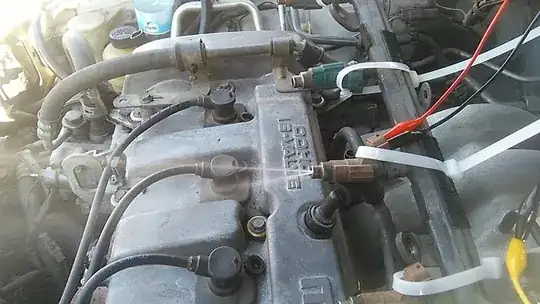

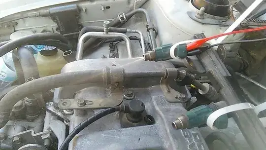

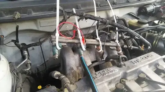

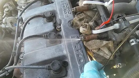

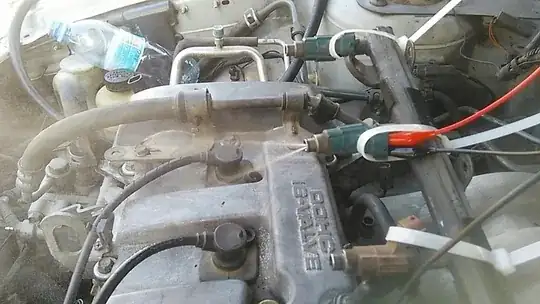

I also took some video of the spray patterns for each injector and here are some screen shots:
Injector Number One
Injector Number Two
Injector Number Three
Injector Number Four
The most I can say about the spray patterns is that they don't look identical to each other, which I would expect them to be. Now some that may be due to viewing angle, but it seems to me there is more variation in them than that can account for.

I would try and clean the injectors first. They are putting out the same amount of fuel for the most part. Your deviance of 60-62 ml per 15 seconds really isn't much. Even your "Try 3" shows you were pretty much right in the ball park with only 1ml of difference across the board.
If you can get a standalone fuel pump to pump your homebrewed SeaFoam through your injectors, this is where I'd start. This should clean up any deposits within the injectors. If you do this, ensure you are cleaning them both ways by pressurizing from the nozzle side as well as the rail side. By doing this, you are ensuring any thing which may be caught one way or the other is getting released. Running SeaFoam through these should help with the spray pattern as well as with stiction if there is any going on.
After you get them cleaned properly, recheck your spray patterns and see if they aren't noticeably better. Then also, do your leak down again to see if #1 & #4 are still showing wet. If they are still showing wet, I'd consider getting new (or refurbished) injectors. If cleaning doesn't allow them to stop leaking, the problem lies in the plunger, not in it seating fully. Getting a matched set may not be a bad thing. The leaking could most likely be the issue with your rough idle. If the two injectors are releasing or allowing to release more fuel than they are supposed to while running due to the plunger not closing quick enough, it would be releasing extra fuel every time it cycles, causing a rich condition in the two cylinders, which would be more than enough to cause the rough idle. It may not show up in a flow test because it is just one cycle you are accounting for. This is a long shot (more of a spitball), but at least one place you want to start with to validate or invalidate your thinking.
I was slightly worried there might be an issue because it appears you are using two different types of injectors, as noted because of the different body colors. Usually different colored injectors, especially with Ford and Ford related injectors (Mazda and Ford are completely in bed together, btw), usually is meant as a means to tell injector flow rates. This was tempered quite completely by your flow results.
Even with the leakage from the #1 & #4 injectors, it doesn't appear there is that much leakage. I don't think it would fully account for the amount of pressure drop you are seeing over the given time period. This would lead me back to the flow back mechanism in the fuel pump. I'm not sure if this would be causing your rough idle, though. Hard starting, maybe, but not the rough idle. I believe once you get the #1 & #4 injectors squared away, your idle problems may be fixed.
