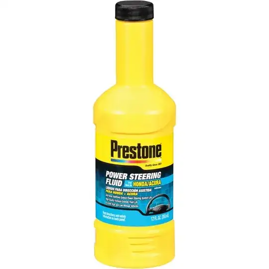

You do not need to use "Genuine Honda" power steering fluid. You do, however, need to use power steering fluid made for Hondas/Acuras. If you look at any manufacturer specific manual, you'll see they will specify "genuine" this or that. This is a means to get you to purchase their products. Most often there are alternatives.
You cannot use just any power steering fluid in your Honda. There are several manufacturers out there who make it, such as Prestone.

totally different formula and weight. Use only fluid designed for asian systems or honda accura fluid. available form dealer, prestone and beck arnely.
The Prestone Synthetic Asian formulation power steering fluid for Honda is $6.99 for a 10 oz bottle at Walmart. I flushed my '06 Accord ps system with two bottles at 130K. Another few K and I'll flush it with another bottle. Also bought a case of DW-1 ATF for under $100. Drain and fill every 50K. Cheap insurance.
