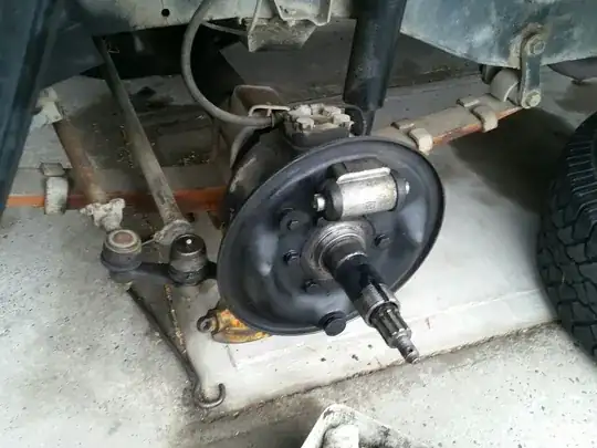

Here's the stub axle in the wheel well - there is nothing there that can hold the road wheel and nowhere to attach the wheel. The big black circle is the backing plate for holding brake shoes.

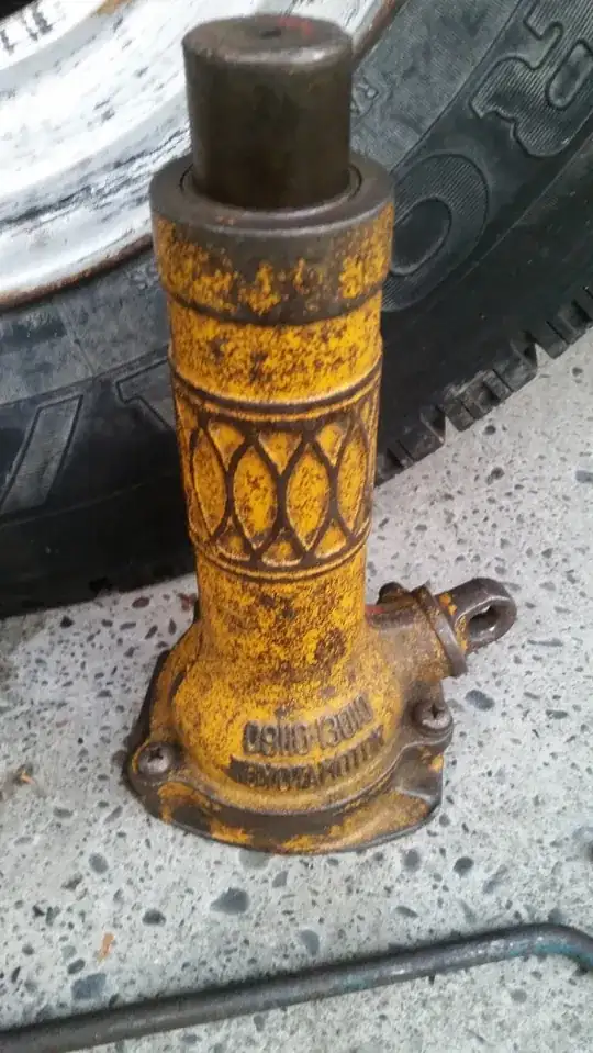

The vehicle stayed on the jack for 5 days. Here's the jack that did it:
It is rated for 0.7 tonnes so 700 kilograms and held the front axle at the leaf spring plate. The road wheel, FWH and drive plate, brake drum and shoes were all removed, saving maybe 40-50 kilograms.
So it was fine for me, but YMMV. I would not have done this if there was any slope, or risk of being pushed off. The tyre was under a chassis rail as a secondary safety.

Leaving the car jacked for a long time is very risky: remember jacks are designed with systems for lifting and lowering a load. Some use hydraulics, other a screw type system but all of them works under a lot of stress because the huge load they need to handle.
They should be solely used only for lifting, then use a jack stand to do the load support job. Jack stands are the safest option: they don't have any system that can yield down with time.
I have seen and even had hydraulic jacks that after a few minutes under load they started to low down because the internal rubber seals were gone!

There's a difference between a jack and a jack stand. I've left vehicles on jack stands for days, even weeks, but a jack, regardless of type, is prone to failure: they are designed to raise and lower, not to hold.
A jack stand on the other hand is a solid piece of metal and is designed to hold. If you don't have jack stands, I strongly recommend you acquire some (at least a pair, preferably 2 pairs). When I expect to leave a vehicle up, I like to have it (ideally) up on 4 jack stands (so that the vehicle is rather level), or at least up on 2 jack stand (i.e. the entire front is up: I have this weird theory that cars don't like to be twisted by having just one corner up in the air).
Finally, you shouldn't have been working under your Land Rover without at least a jack stand. But good call on sticking the wheel on its side under the frame, I do that too in case something tips over.

Having had several land rovers, if your jack is under the spring plate then it should be fine and not slip. If you have a couple of solid blocks then put them under the axle as well and lower down to the blocks to take the load off the jack.

For extended time or to work underneath, you need jack stands or wood blocks. Hydraulic jacks can leak down with time , and if they leak only once - it does not matter that it never leaked before.
