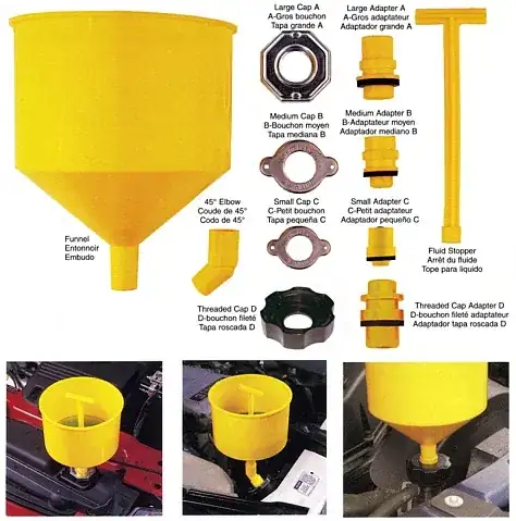

I'd agree with Paulster2 that you don't have enough coolant in the system. One thing I've found extremely helpful in getting cooling systems properly filled up is one of these Lisle 24610 Spill-Free Funnels. I think I first saw one in an EricTheCarGuy video:
Basically, it let's you get the coolant level higher than any other part of the cooling system, and you can run the engine with it connected to help get air out without worrying about spilling coolant all over the place. There's a nice thread here that talks more in depth about it.
