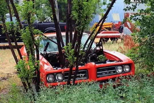

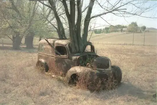

I think the real danger is a tree growing up through your vehicle. Tree sap can be washed off, and a car can be repainted, but it's much more work if a tree grows through your car. Here's some pictures of the devastation that can cause to a vehicle...
