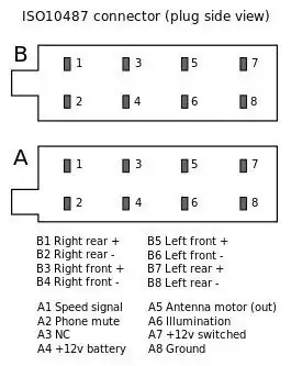

When it comes to connecting it to the stereo, you need to check the loom at the back of the stereo. Volkswagens on this period use ISO standard connectors which have one set of wires for power and the other for speakers. These are typically in the form of one black and one brown (although I have seen white) and the have a tab at one side to clip them together.
The pins for the rear speakers at the outside of the speaker connector. See the image below. More info about the ISO connector is available here.
ISO pinouts
