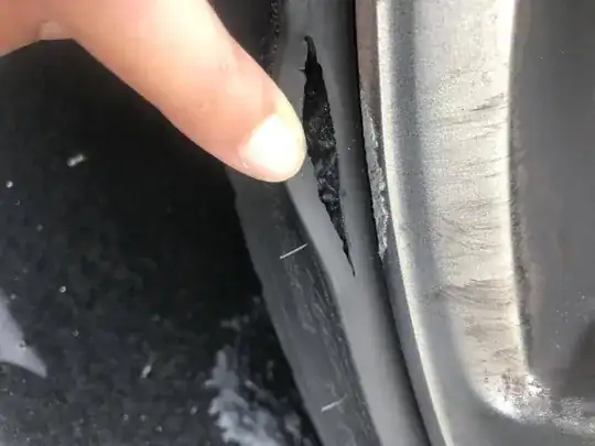

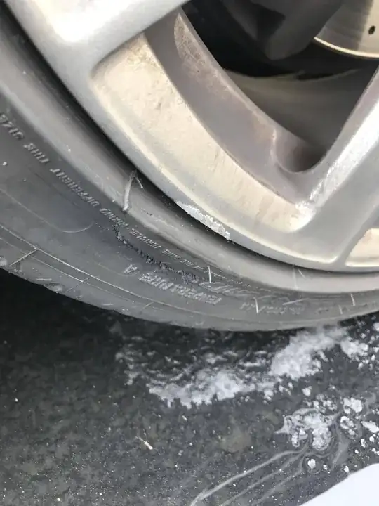

I just recently curbed my rims on my Lexus IS F 250 every drivers pet peeve! The rim damage is fixable I know but my main concern is do I need to replace the tire? I see no threads , and there is no air leakage. It's honestly not deep I wouldn't even say an inch. It's mainly the tire protector part. My only stall is if I change one tire I have to change all. I don't drive on the freeway , I'm really not a everyday driver besides weekends.

This looks like the low-profile tire fitted on my IS350. I've had a few chunks missing from one of my tires for more than a year now without any issue.
You should be fine as long as that tear is pure rubber and the tire's wireframe hasn't been exposed.
