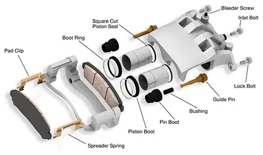

Caliper Diagram
The two pieces marked as "Pad Clip" and "Spreader Spring" are meant to be there. If they aren't, get some new ones. If they are, check they're not rubbing on the brake rotor. Also check there's some anti-seize on where the METAL parts of the pads touch any other metal parts of the caliper assembly, but make sure it's a fine amount; Too much may get pushed onto the braking material on the pads or on the rotors themselves. It doesn't take a rocket scientist to figure out why that'd be a bad thing on something that works with friction.
