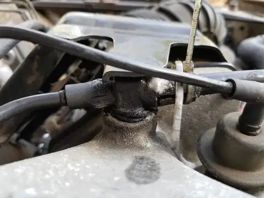

While inspecting closer I found this piece connected to the PCV hose near my throttle body that inserts into the air intake manifold. Not only are there zip ties holding the hose together, but it appears that someone's also tried to use superglue to hold it together.
The white spot on this connector is hard and crystalline, like dry superglue: enter image description here
Since this car is my only way around, I was too afraid of the thing crumbling to pieces if I handled it too much, so I didn't want to pull it apart to get a better look at it.
I haven't been able to figure out what this thing is called to make any headway in searching for a replacement. What is this peice called?

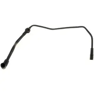

That is a PVC valve hose assembly. They are inexpensive (less than $10 in my area) and fairly straight forward to replace. This connects the PCV valve to the manifold (the connector you pointed out) and also continues back to a vacuum manifold behind the engine.
Had to replace this on my daughter's car that has the same engine. The connectors were dried out and cracked. This caused a vacuum leak and a CEL for a lean code.
It took me about 30 minutes to replace because the bracket over it has to be taken loose and the tube routed the same way as the original.

It looks like a "tee piece or connector" - this is where the depression comes from to absorb the air/gas/mixture from the crankcase into the intake.
