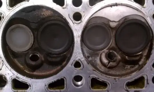

I actually didn't break the hex free, and nothing was coming out. No hex, no extractor, it was all stuck in there. To top it all off I dropped the only crucial socket that I didn't have a backup for somewhere in the valley of my engine. In a fit of rage, I threw my tools down and called for a tow. I told the mechanic (not my buddy) to remove the head and tell me what he saw.
{picture}
I blew out the backend of my head.

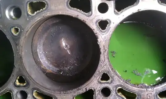

But wait you say! If you blew out the backend of your head, what were you extracting?
{picture}
I confirmed with the mechanic that the only way I was extracting directly into the piston head was that it was in the absolute top position (think 1/100,000,000). I ended up buying a replacement head, ignoring the mechanic's advice on replacing the engine (due to the scored piston) and replaced the head with a mechanicfriend in exchange for some computer work he needed done.
The mechanic said the car wouldn't run 10 miles on a scored piston. Some youtube videos, a couple bucks for tools, elbow grease and a mechanic friend and it seems to be doing fine. I've put 7,000 on it and am glad it hasn't blown up yet :)
