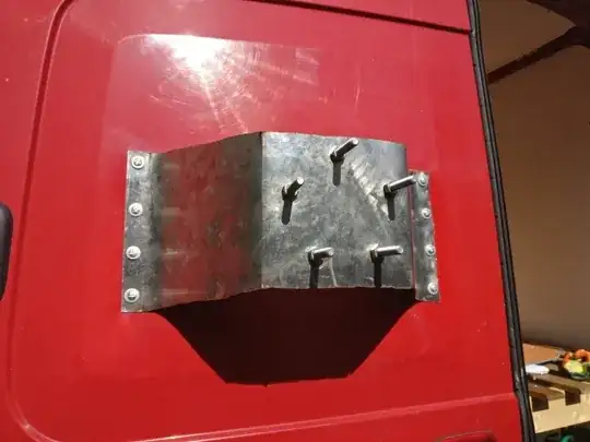

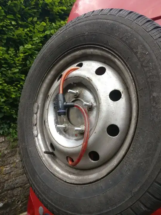

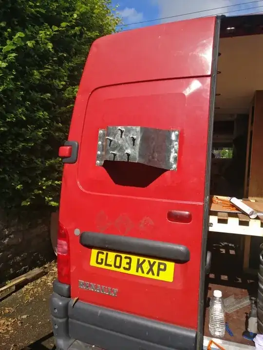

For anyone interested... This is what we ended up doing...
custom made tyre bracket close up custom made tyre bracket with whole door custom made tyre bracket back custom made tyre bracket with bike lock

Leonardo - thanks for posting this, I have movano and have been considering mounting on the rear door. I asked a door kit supplier Foundry 4 x 4, but have not as yet received a reply. The options are limited, as to mount under the van only allows just over 7" clearance, ok for a car but I wonder about insurance re modification, plus if you go off road, or a worn pot holed track. Bill
Looking at some conversions seemingly best option is to utilise the existing door hinges to support a wheel carrier. Such as wheeliams.co.uk, but looks like they do not now produce for older vans I think, I’ve dropped them an email to find out as we have a 2007 master that I want to hang the rear wheel on.
