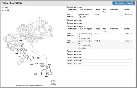

According to This ford specific parts website you are looking for part number 6C639 (or possibly 6600 if I am misunderstanding your description of the part) image from ford part website showing the diagram in question Note the square and circle in the top left corner used to denote which gasket is which. Don't let those prices scare you, searching for the same part number on Amazon finds it for 10 USD.
