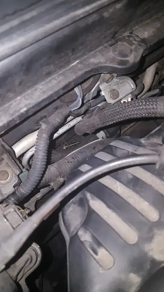

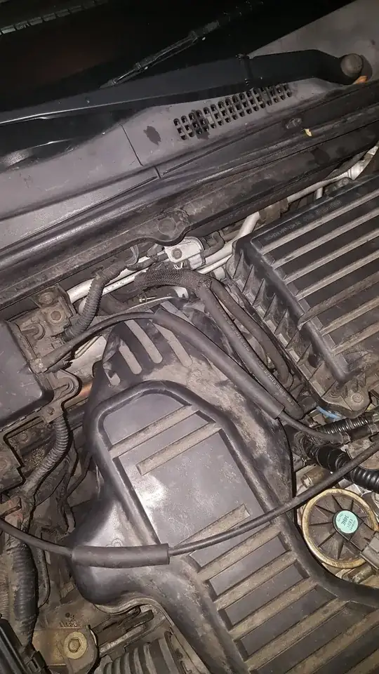

I found this bolt sitting above the thermostat/behind the VTEC solenoid (I think)???? enter image description hereenter image description here

Your mechanic messed something up (or forgot something) as we thought before. It's that shop's responsibility to fix their mistake. Once again, we're talking about a high rpm issue and my first thought is still an oil pressure problem in a variability sensor. (This doesn't mean I'm correct, just my guess). You're going to need to demand that they fix the problem they caused so you don't have to put up with all of this nonsense. And there's the little issue of the fact that it's their job!
