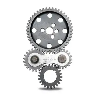

Here's one for a small block Chevrolet engine:
Edelbrock Accu-Drive Gear Drive on Summit Racing
Just as you describe, there's an idler gear (well, maybe two) which keeps things in time.
These gears are used mostly in racing applications. They aren't usually used in street applications for two reasons:
  • Cost - These cost anywhere from four to ten times the amount of a regular timing chain setup.
  • Noise - Due to the fact the gears are cut straight, these make a lot of noise.
The reason racers use them is because unlike a timing chain, there's no slack. Timing is kept in check very well. Also, as timing chains wear out, they stretch. This changes the timing just enough it can affect performance. When you are racing, especially bracket racing, dialing in your performance is a must. Using the gear set over a chain can provide you a little extra insurance to know things will be the same again and again.
