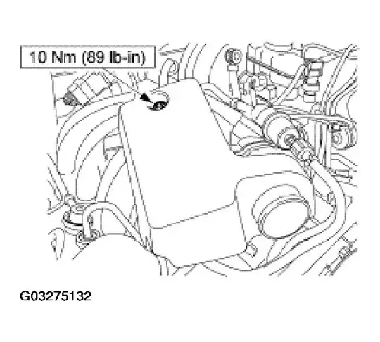

Disconnect the battery ground cable. Remove the air cleaner outlet pipe. Remove the bolt and the snow shield
Fig 7: Removing Bolt And Snow Shield enter image description here

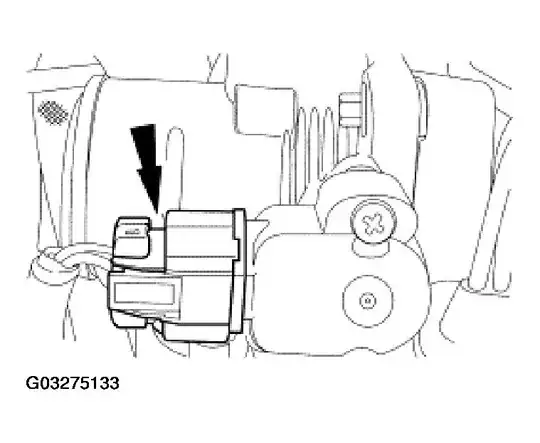

Disconnect the throttle position (TP) sensor electrical connector.
Fig 8: Disconnecting TP Sensor Electrical Connector enter image description here

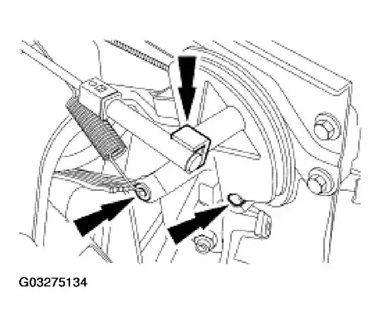

Disconnect the accelerator cable, the speed control cable and the return spring.
Fig 9: Disconnecting Accelerator Cable, Speed Control Cable And Return Spring enter image description here

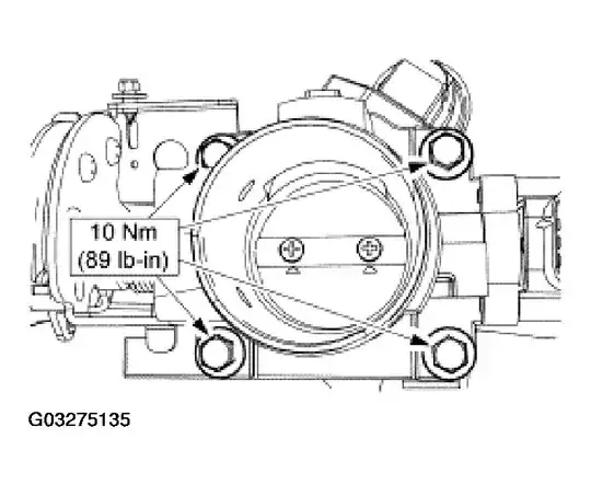

Remove the bolts and the throttle body.
Fig 10: Removing Throttle Body enter image description here

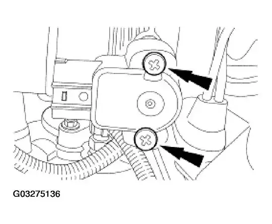

If necessary, remove the TP sensor.
Fig 11: Removing TP Sensor enter image description here

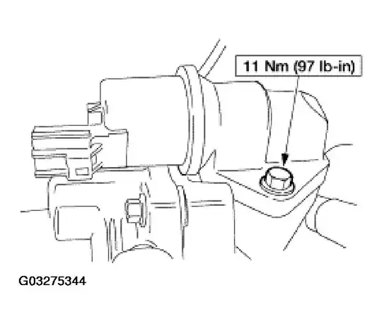

IACV

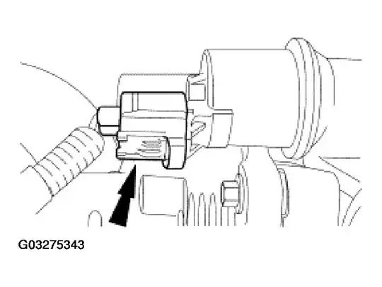

Disconnect the idle air control (IAC) valve electrical connector.
Fig 3: Disconnecting IAC Valve Electrical Connector enter image description here
Remove the IAC valve and discard the gasket.
Fig 4: Removing IAC Valve And Discarding Gasket enter image description here
NOTE: Install a new IAC valve gasket.
To install, reverse the removal procedure.
