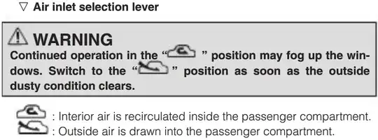

You don't have the air inlet selection lever set to recirculate, do you?
