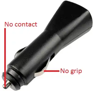

The cigarette lighter outlet was never designed to be an electrical outlet the way it's commonly used today. Even so, I've yet to find a plug for charging USB devices that fits and doesn't fall out.
All plugs I know have some little metal nub in the center that practically never gets enough contact with the socket's center base, and the sides of the plug are never effective at keeping the plug pressed in well enough.
How can I make the plug stay in place? How can I easily modify the socket to make it work?
My car's socket is vertical (pointing straight up). I don't want to dismantle my car, although it would be cool to have a USB socket in the console! This must be a common problem; how do people solve it?

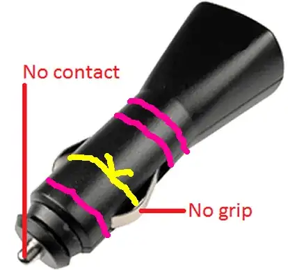

(1) Use a tightest fit rubber 'O' rings around the plug - available from http://www.amazon.co.uk/Assorted-Rings-Plumbing-Rubber-Thread/dp/6040360860 - see pink bands on the image below.
(2) Use a short length of plastic-coated WIRE or a WIRE cable tie like those small black ones you get around a power cable when you unbox a new appliance (NOT a flat plastic 'garden' cable tie). Thread the wire THROUGH both the 2 silver spring contacts on the side of cigarette plug and twist the ends together to tighten it around the socket, than press/flatten the twisted ends to the socket - see yellow band on pick below. The good thing about this method is that the silver spring contacts stop the wire tie from rolling off. This worked so well for my loose USB cigarette charger that I have to give it a real tug to get it out! socketwithbands

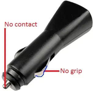

I had the same problem with one of those cheap mp3-FM transmitters. The thing is that some lighter sockets aren't deep enough to accept the adapter, so the wings never go deep enough to click into the recesses of the socket. The best thing to do would be to find an adapter that plugs into the socket and then plug your USB adapter into that. Some hardware stores sell an adapter that turns one socket into two. Or you could try some DIY-fu and bend the wings forward and back to move the bulge closer to the front. Just be VERY careful not to snap them off. That metal is quite brittle. See the blue line I "Photoshopped" in ;)
