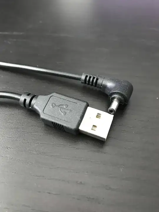

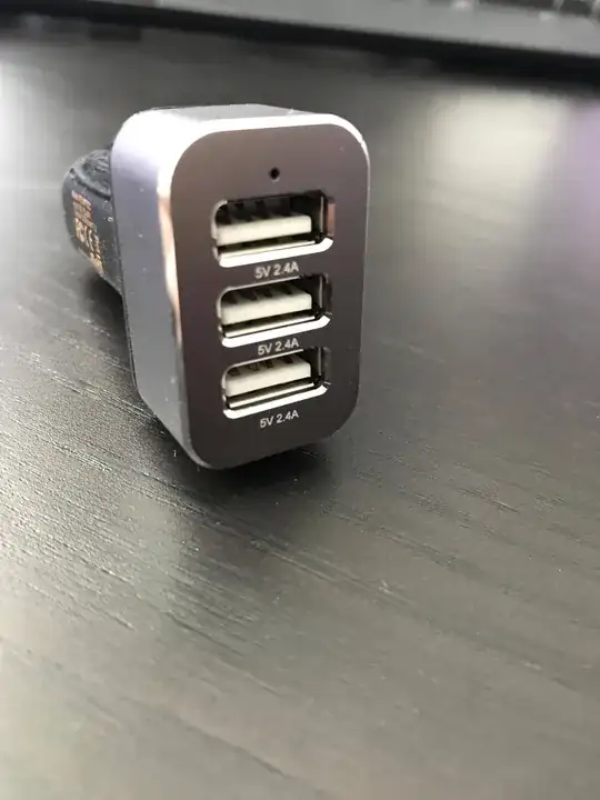

I want to test out the charging unit and usb cable to make sure they're not defective and causing a short. I have attached a picture of the charging unit and usb cable below.

As @sweber says, the fuse in your lighter socket should be 10 or 20 amps - the adapter states 2.4A per port, so even if you had three things charging it should only be drawing 7.2A (say 8 to allow for inefficiency). If you're blowing the fuse, that suggests to me that, as you suspect, there is a problem with either the charger, the cable or the camera, that is causing a short and blowing the fuse.
You should be able to test the cable with a multimeter - set the meter to "continuity" (which on most meters will buzz when there is a circuit between the two probes), and check there's no short between the inner and outer pins on the camera end - wiggle the cable around a bit as you do so in case it's an intermittent one. It's a shame it's not a standard USB-USb cable, as my usual advice here would be to try a known-good cable.
I suspect the best way to test the adaptor is to try a different one - there's loads out there so you can pick one up for very little, and they are always a useful thing to have around...

I once blew a 15A fuse with a cheap 1.5A charger, my device was a phone so I believe it is unlikely to be the camera the problem probably the charger is doing a short circuit I suggest trying another charger and also reading the camera specs
Dump your no name charger and cables. You are drawing way too much current and blowing fuses.
Something you're plugging in obviously has an internal short and it sounds like the dash cam. You are risking damage to your fuse box, socket, or fusible link somewhere.
Try a different quality charger and cord, and if it still blows a fuse get a new dash cam.
