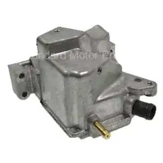

The hose in question routes just behind the passenger side valve cover. Follow the secondary vent tubes out of the back of the manifold. They meet in a "Y" and continue into the valve.
Just to the right of that, there's a brass looking fitting over which the primary vent tube fits. See the image below.
To get the right size hose, I suggest taking the plastic assembly off the top of the manifold and taking it to the parts store to ensure a perfect fit. You'll need somewhere around 20 inches. My parts store sold it by the foot. I got 2 feet and didn't have to cut it down.
While still imperfect, replacing this hose and doing some throttle body cleaning while I had it apart made a big improvement in the way the engine runs and idles.
Standard® V545 - Intermotor™ PCV Valve
