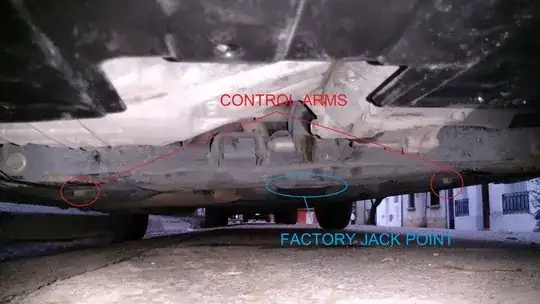

First problem is that my jack isnt long enough to reach the fron jack point which is located in the middle, behind the engine, almost where the doors hinges are.
I cant jack from weld pinch on sides because then i cant put the jackstands.
I cant buy ramps for now because they cost almost like a new jack (of the expensive ones. u$300 so you have an idea.)

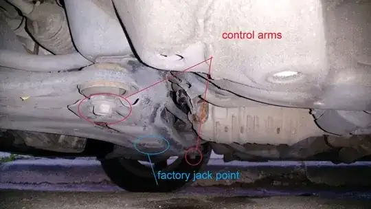

I will try to reach the middle jack point from behind the front wheels, but then i also have the problem that the jack doesnt raise the vehicle enough to place the jack stands, although i made a 10 cm wooden base to place the jack onto.
My question is: are there other safer spots in a honda fit 2008 that i can use to raise the car and place the jack stands? I thought of using the bolts that hold the control arm of the front wheels, but im not experienced.
UPDATE:
I've been told by a buddy that i can raise the sides from the control arm bolts and that he always uses this points to jack up the car from the sides and then put jack stands on the pinch welds:
I've seen mechanics doing it on the street in other cars.
Is this okey?

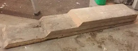

This is a common issue, and here are various solutions that I have personally implemented to get around this restriction:
  1. Build your own ramps. Get pieces of wood that are at least 2x8 (make sure they are wider than your tires). Each ramp will need 3 pieces, each about 1 foot shorter than the next, and cut the edge on a 45 degree angle. The picture below is 1 of 4 identical ramps I've built. Two of my vehicles weigh about double what your Fit weighs, so don't worry. I used 2x12 boards that fell off the fence :) enter image description here
  2. Get a proper jack. You mentioned jacks with a higher jacking height are expensive. This is true of trolley jacks. Find yourself a bottle jack. They don't have wheels, but they can lift more weight and they can lift higher. I picked up a 6-ton bottle jack for $12 I believe, and it goes higher than my trolley jack.
  3. Use a piece of wood between your jack and vehicle. As suggested by Paulster, get a thick piece of wood to give you more height. I've done this, and then I got scared the wood would crack and bought a bottle jack.
