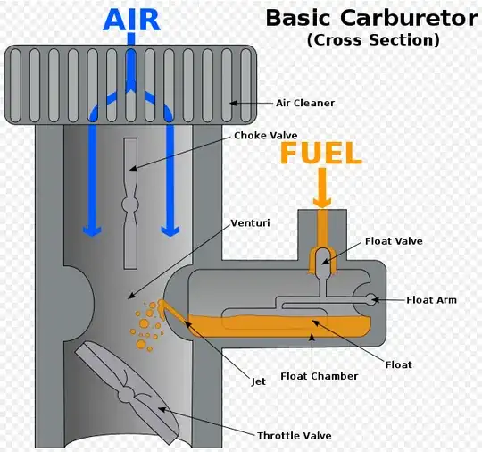

No, a choke cannot compensate for dirty carbs because you'll never get full power out of your motorcycle if you run on it. Here's a picture of a carb: Carburetor
When you pull the choke it closes the choke butterfly valve or a choke plate, reducing the airflow and richening the mixture. That means no matter how much the throttle valve opens you will not get full airflow, so you won't get full revs. It's not a good idea, I'd only do it to get to a place I could get things fixed.
